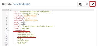

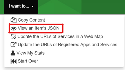

For whoever else with the same issue (and myself in case I forget how to do it):
  • Select the map to take off Field Maps. Its JSON will open in a pane on the right.
  • Select "Edit JSON" (pen icon in top right corner). Under "typeKeywords" add "FieldMapsDisabled".
  • Save and close. The map will disappear from Field Maps after refreshing.
