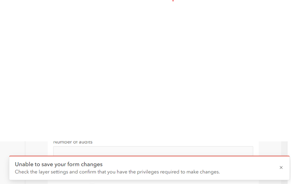

I have been working on a fieldmap app for a few weeks until suddenly a few days ago when I went to make a change to the and save the below error appeared stating that it was unable to say my form changes.
It is telling me to check the layer settings and confirm that I have the privileges required to make changes.  The layer has been set to allow editing and I am an administrator.
Is there something I am missing here?

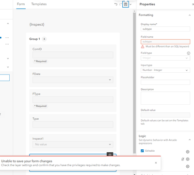

Do you see any other errors in your form in the Properties tab, for specific fields? There is a known issue where we are getting hung up on reserved keywords that we are working on fixing. If the fields are existing in the Feature service (ie published from Pro or another source) we should be ignoring this restriction when the form is saved. Example below:

ColinLawrence, you nailed it!
We had a field named "Year", a reserved SQL keyword. Removed and changed slightly. Although it's peculiar because that field has been in place for a long time and never caused the save issue or errored before. Oh well.
ColinLawrence
Great! Yep, that was not an intentional change. A fix should be deployed in the coming days which will continue to allow this configuration as before.
