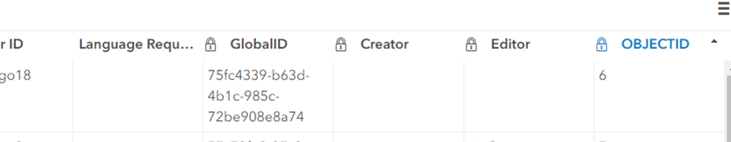

Hello all,
We are working with a feature layer associated with Field Maps, and are wondering why the Creator and Editor fields are not populating.  These fields have populated with the account with which a feature was created for us in the past.  Currently, both of these fields are returning as blank for all created featured.  We would like to track from which account a feature is created, and currently there is no return in these fields.  We attempted to export the data as well, and see that the fields are still blank.
Is there something we missed/a setting in permissions that anyone could point us to?

We do have that option enabled, and values will appear for the editing account for any edits made in AGOL, but it still is blank when a feature is created.  The Creator field is our main concern.

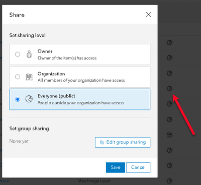

In my case, somehow the share setting in Server Manager:
were different than the share setting in the item itself:
Once I changed it to match in Server Manager all was well.
