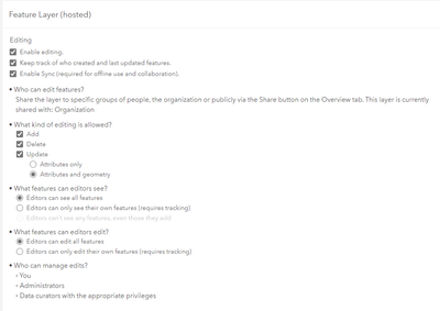

First, make sure all the editing is enabled via the feature layer settings.

After enabling this setting, I was able to delete features on the map as well as desktop.
