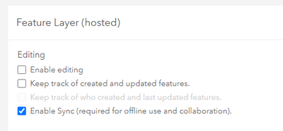

@lxd have you enabled sync on your non editable layers? This needs enabling to be able to take features offline, whether editable or not
If your non-editable layers aren't hosted and in a registered datastore, then stick them in an SDE (Relational Geodatabase) and enable archiving.

No, I still don't know how to take the map offline with my not editable layers.  The layers are in SDE (enterprise geodatabases), the sync is enabled when publishing. The layers are non versioned and have archiving enabled. When I publish the same layers with editable database connection, maps has "offline" option, with viewer database connection, with sync enabled, the offline option disappears.
