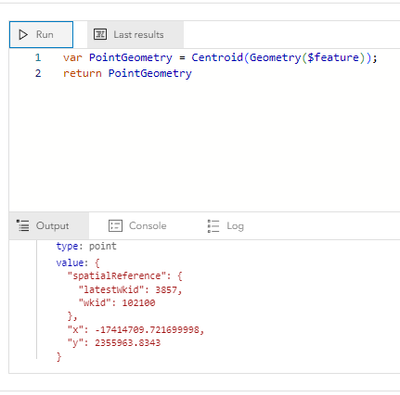

MarkBockenhauer
I gave it a try...  the Mapviewer is returning a different wkid than Field Maps.
Field Maps returns
{"x":-17406622.0088,"y":2383466.8805,"spatialReference":{"wkid":3857}}
This inconsistency can be worked around by adding another IF accounting for 3857 line 8
if (ArcadeSr == 4326) {
  Console("4326 Spatial Reference - No Conversion Necessary");
  Latitude = ArcadeY;
  Longitude = ArcadeX;
} else if (ArcadeSr == 102100) {
  Console("102100 Spatial Reference - Conversion Necessary");
  AuxSphereToLatLon(ArcadeX, ArcadeY);
} else if (ArcadeSr == 3857) {
} else {
  Console(ArcadeSr + " Spatial Reference is not supported - currently works with Web Maps where the basemap is in WGS84 (4326) or Web Mercator Auxiliary Sphere 102100");

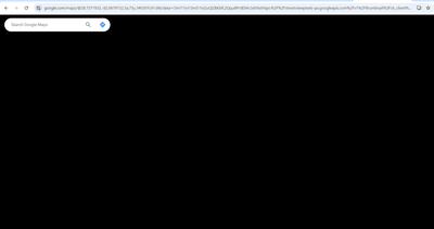

Just noticed that the StreetView links that I was able to use and worked before on pop-ups does not work anymore and just produce a black screen nowadays.... Google probably changed the correct format for StreetView links? This seems to ne an issue on desktop browsers and not on iOS devices at least when I tested it.
LindseyGreidanus
I have noticed that issue to. I do think it is on Googles side as well, but I have found that clicking the url and refreshing on the black screen makes the street view image appear again.
Ramon_de_Leon
@LindseyGreidanus , thank you for the tip on refreshing the browser, that worked and a useful workaround until it gets a fix.
Ramon_de_Leon
Interestingly, this seems to be an issue only for Google Chrome.... if you use the same url in Edge or Firefox, you don't get the black screen and need to refresh....
LindseyGreidanus
I am using firefox and get the black screen, and others in my office are using chrome. I have not tried with edge yet.
Edit: I tried out edge and it looks like it works without the black screen for me 🤔
Ramon_de_Leon
I have an older version of Firefox Version 112.0, that may be the difference maker...
