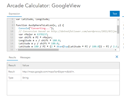

anonymous55
Thanks for respond I am getting this result
RhettZufelt
MVP Notable Contributor
What do the console messages say?
R_
anonymous55
Use Console Function to output messages.
102718 Spatial Reference is not supported - currently works with Web Maps where the basemap is in WGS84 (4326) or Web Mercator Auxiliary Sphere 102100

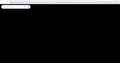

Ramon_de_Leon
Just noticed that the StreetView links that I was able to use and worked before on pop-ups does not work anymore and just produce a black screen nowadays.... Google probably changed the correct format for StreetView links? This seems to ne an issue on desktop browsers and not on iOS devices at least when I tested it.
