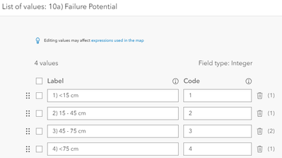

I am using for my 3 fields a combo box, 1st is the label then what value I would like it to be, see from my example below.
I have used the codes:
var myfeatures = FeatureSetByName($map, "Layer Name")
var sum1 = Sum(myfeatures , "failure_potential")
var sum2 = Sum(myfeatures ,"size_of_part")
var sum3 = Sum(myfeatures ,"target_rating")
return sum1 + sum2 + sum3.
It doesn't throw me back a value, irrelevant of what values I put in for:
failure_potential
size_of_part
target_rating
No 100% sure where I am going wrong... The values are integers... That's a good start.
