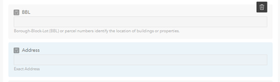

Hello
I have this code which is from Esri blog and I am trying to return exact address values from parcel data (MapPLUTO) but I don't want to retune Null values instead I want return Not Detected for Address field for cases which code can find address
