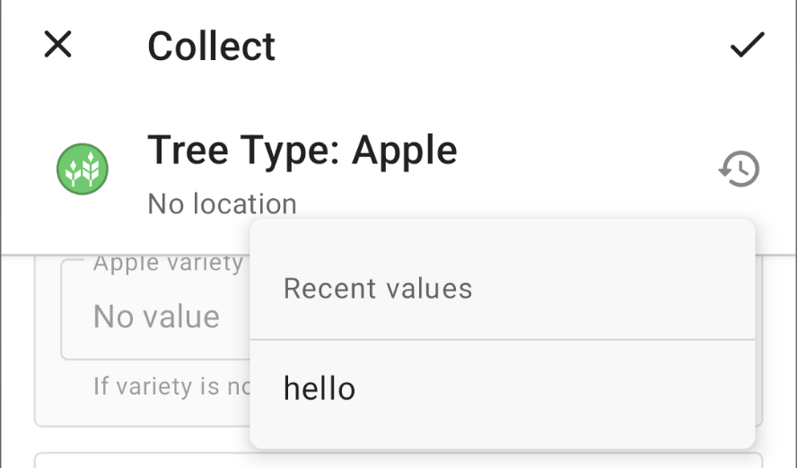

If you are on Android, recently entered values can be accessed by tapping the clock icon in the Collect panel, shown below.  Tapping the value will populate the field with it, and you can increment it from there. Screen Shot 2022-03-11 at 1.17.58 PM.png
