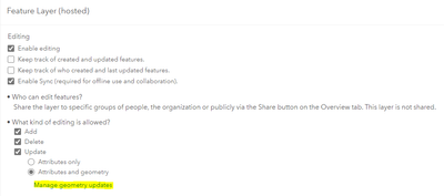

@SzuNyiapTang I have set this up now. I would like my metadata (parent) data points to be edited differently to the related salinity points, i.e. the field worker should not be able to delete or add metadata points, only edit attributes, but have full editing types for the related salinity points. Is this possible?
I tried creating a view of either layer but this breaks the relationship.
SzuNyiapTang
Esri Contributor
Hi @kawakawa4
It does not have that level of detail of access. The most you can do is to prevent the editors moving the parent layer in which you can disable geometry updates on the parent layer.
