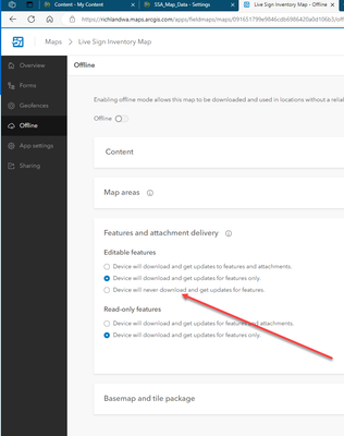

Download updates for features and attachments is enabled in the Field Maps Designer configuration menu.

Are you using the same map for offline and live field map editing?
In Field Map Designer, Offline features and attachment deliver, is it set to not update feature?
R_
GarrettHerrin
The maps are separate but contain the same layer. It is set to download and get updates for features and attachments in the settings under "Features and attachment delivery."

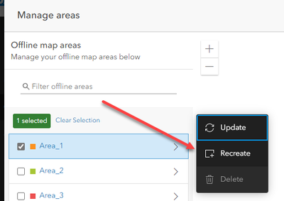

Hmm, not able to reproduce.  Perhaps something 'changed' since the offline areas were created (my offline areas 'changed' on 6/5 for attachment size and started overloading my offline sync with 'actual size' images, even though they were set to medium.  had to change, save, change back to medium, save, and re-create offline areas to fix,  this also affected the live mapping though).
You might try syncing all your offline maps, then remove the offline area(s) from the device(s), and re-create the offline areas in Field Maps Designer (re-create seems to capture 'changes' that update doesn't).
Then re-download the offline area(s) and test to see if that resolves it.
Make sure everything is synced to the source data first, as once you remove offline area from the device, any edits are gone.
