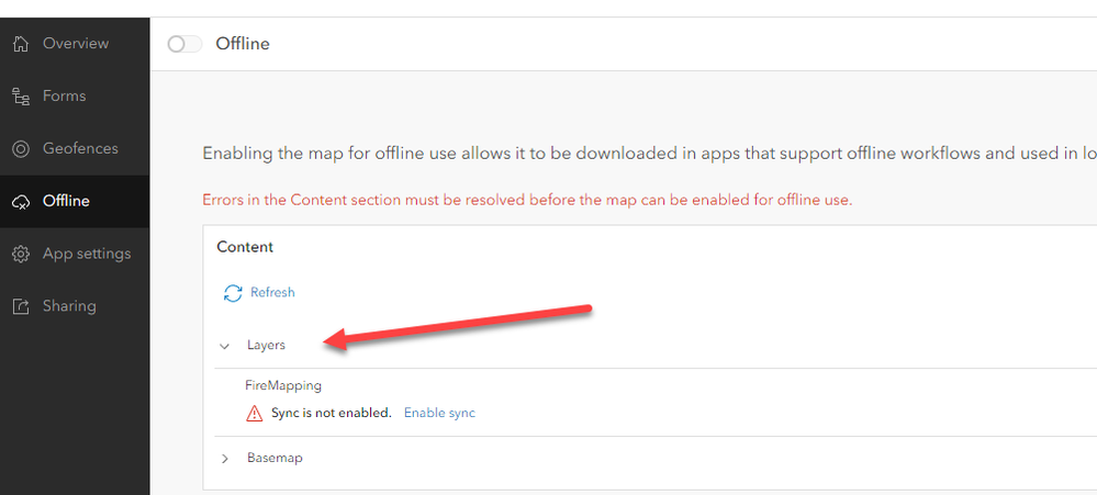

Do you have any nightly scripts or updates to the data?
If you look in the Offline tab of Field Maps Designer, does it show any messages there that might give you a hint?
Above pic is example of HFS that was overwritten and sync not re-enabled, so disables offline capabilities.

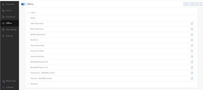

Bio_GIS
Thanks for the reply!
I don't see anything suspicious:
Thanks again,
