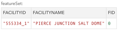

The code works but it only gives me one result (which seems odd but I'm new)
Screenshot 2025-03-26 at 3.40.59 PM.pngScreenshot 2025-03-26 at 3.40.59 PM.png
