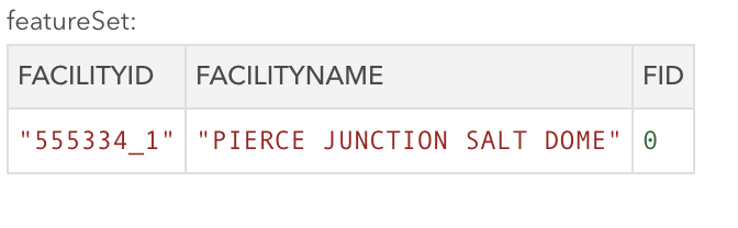

The code works but it only gives me one result (which seems odd but I'm new)
