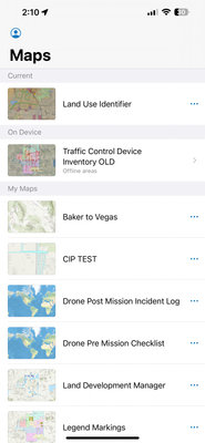

 Here is a screenshot of my Field Maps app. I am using an iPhone 13 Pro Max with iOS 17.2.1
ColinLawrence
It looks like the My tracks card (and toggle) is not there at all. This should mean that the logged in user does not have the Location Sharing user type extension (or Tracker license). This license is provisioned as part of the Mobile Worker user type or is an add on license for any other user type.
Was the card appearing previously? I would start with ensuring you are licensed and the license is not expired. I hope this helps!

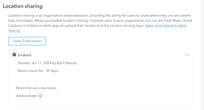

Kohl_Haessly
I was the one who enabled the Location Sharing earlier today with Admin credentials.  Do I need to have another license?
Kohl_Haessly
Okay I see I had to actually assign the license under the add-on licenses section. I see the toggle now. Thank you!
ColinLawrence
Yep, the service and the license are separate things but can both be the root of issues in Field Maps. Glad you found it!
