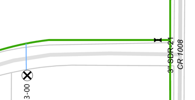

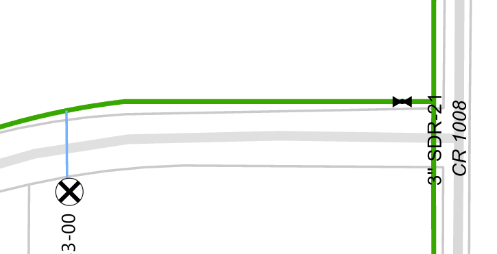

1) Why are my symbols small? The round symbol and the bowtie should both be much bigger. The top photo is from Pro and the bottom is what it looks like in Field Maps.

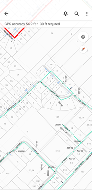

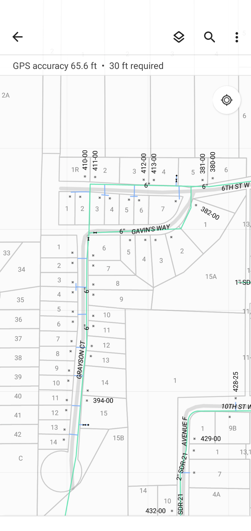

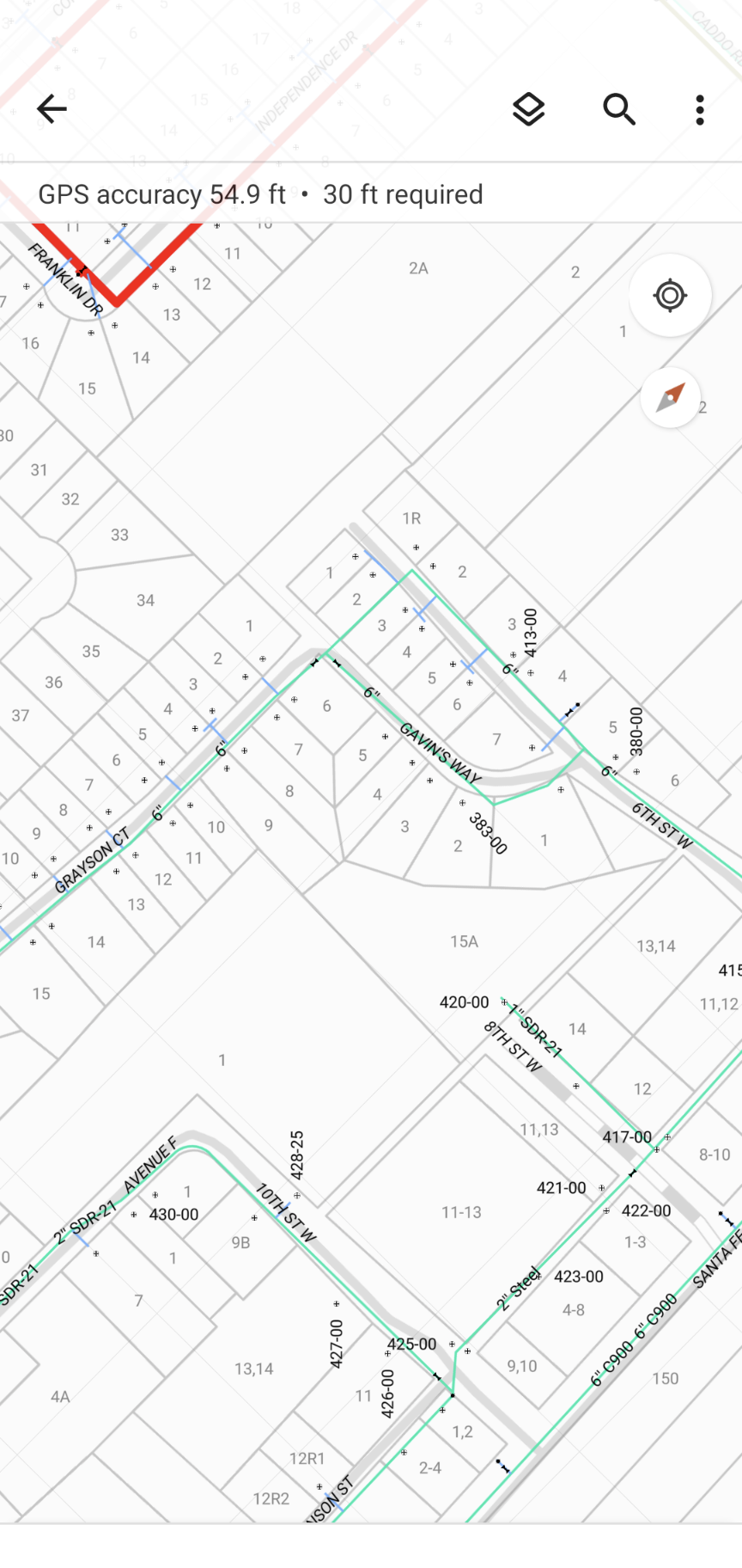

2) When I access the map on my phone, most labels appear but some don't. If I zoom in and move around the map, it changes what is shown. Majority of the labels are okay but some are missing. If I remove download and redownload it is fine for a bit but then does this the next time I open the map. All my labels are Maplex but this is the only layer I am having this issue with.

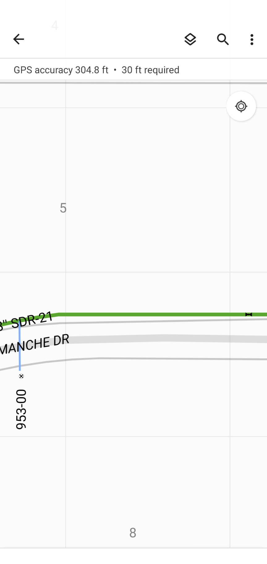

3) When I rotate the map, the labels don't keep their position - I would prefer for them to stay where they are in regards to my map. Not a priority but would like to know if I can fix this.

I saw somewhere else that Field Maps does not support Maplex labeling. It's unfortunate because my labels look so perfect in ArcPro (all street names showing) and then in Field Maps, MMPK the streets look blank until you zoom in really close for some areas.

I haven't figured it out. But I realized that labels rotate like this also in Pro (I think this is new, I don't remember this happening before recent update) if they are not locked in position. So next time I upload the map package for Field Maps I will do so with labels locked in position and will report back.
