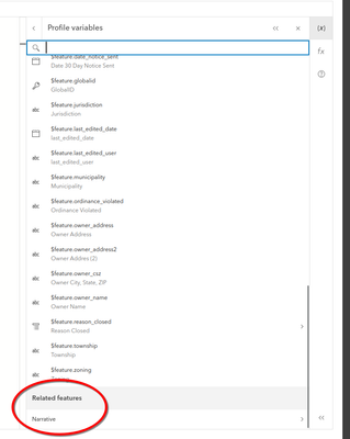

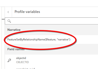

Not the table name, the relationship class. In the expression editor, you can look in the Profile Variables to find the related table:
Clicking on the related table will show you the correct text to put into the function. It may be the table name, but may not. You can see the relationship class name in the Feature Service definition on your server.
