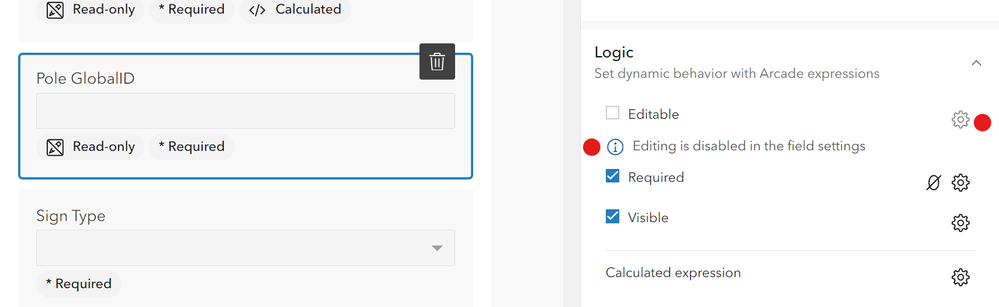

I want Pole ID and the Pole GlobalID to update when I move a sign to a new post in Field Maps/Smart Form online. It currently does not.
The related records on Signs (Sign Maintenance table) also fetches Signs: sign ID, pole ID, sign global ID, pole global ID, and latitude/longitude each time a record is added - to retain the move history over the years (hypothetically).
How might I write Arcade to overwrite the pole's globalID in Signs layer with it's new related pole globalID?
My first thought was doing a "buffer/nearest" pole calculated expression, but it seems once the pole globalid field is populated in Signs upon creation - it is not editable and the calculated expression is ignored.
"Editing is disabled in the field settings". Is this a setting I can modify in the REST API or JSON using ArcGIS Assistant?

Hi @Teresa_Blader - When a calculated expression is used on a field, it becomes read-only so as not to accidentally overwrite the calculated value. That's what the 'Editing is disabled in the field settings' message is indicating. It just means you can't make the field editable, since it's using the calculated expression to determine the value. However, if you were to edit the existing Signs feature, that calculated expression should trigger again. So there seems to be an issue with your Arcade expression as it currently is written.

Settings in field maps on this guid field specifically says “editing is disabled by field settings” and the editing “add expression” gear button is grayed out too - like the picture shows.
So my question is how do I interact with this default field setting to enable editing? Obviously the “add record” button in the form is designed to push the key to the new record, but how could I accomplish this goal of reassigning a sign to a new pole in field maps?

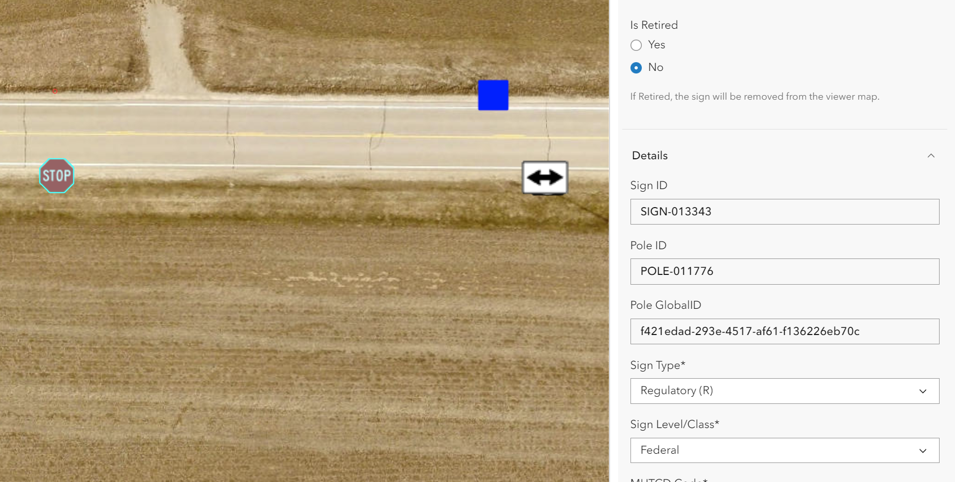

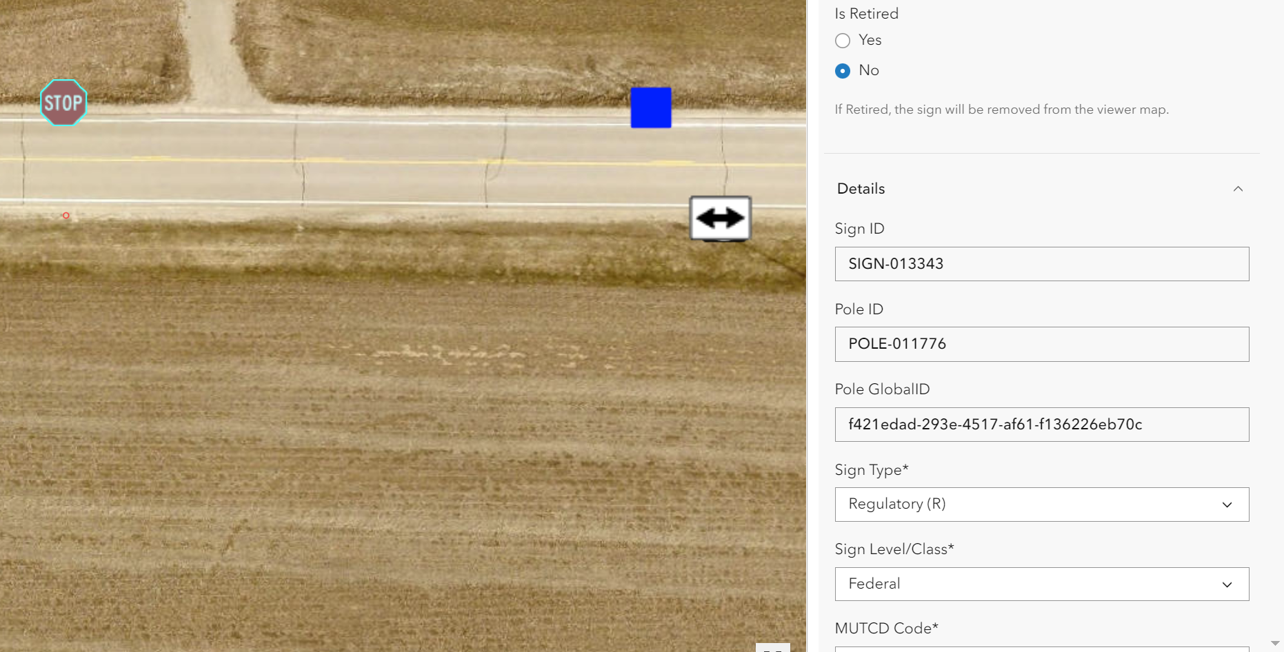

  • 2nd: the concept I used to get the new pole globalid [using this example of grabbing nearest centerlines using FeatureSetByPortalID - which works when the sign is moved 👍] but when I swap out the centerlines layer for the Poles layer portal ID and ask to return the nearest pole globalid, it doesn't overwrite the guid field 👎. It does run and return values in the expression designer - so the expression seems to be operational - just like it is for centerlines.
    • Of course, if the guid is not updating when moved - those other FeatureSetByRelationship won't update either because the guid is how I'm calling attributes in.

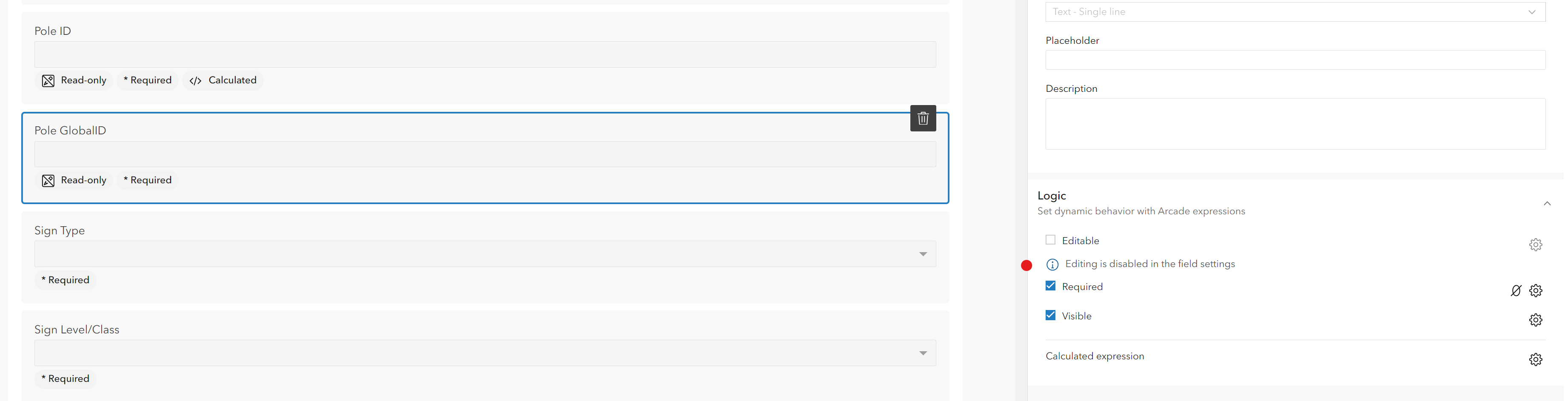

Do you also see on a key field in the form designer in a related layer where the Editable button is greyed out and the "editing is disabled in the field settings" message? I'm wondering if this is normal behavior or if it's something I need to change first.
This is my Signs feature layer form via Map Viewer:

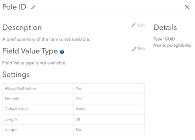

Yep, entering in the expression under calculated expressions is what I'm doing. In my maintenance record table I also pull in the poles globalid into a guid field as well - it is a GUID field, but not the key field, and does not disable editing... so this behavior is not unique to GUID fields in and of themselves but seems to be unique to relationship key fields.
The message I'm seeing related to editing as an indication of a restriction for relationship class key fields. I can edit the guid field using Arcade or SQL.
I have not yet tested the expression with a relationship class key field being text yet as that would require me to overwrite services with a new relationship class - resetting a lot of work for the forms and popups - so last resort here.
Would you be willing to share a screen shot of one of your examples of what you see in one of your form designer layouts for a relationship class key field that is text? Does it show the same message or no?
