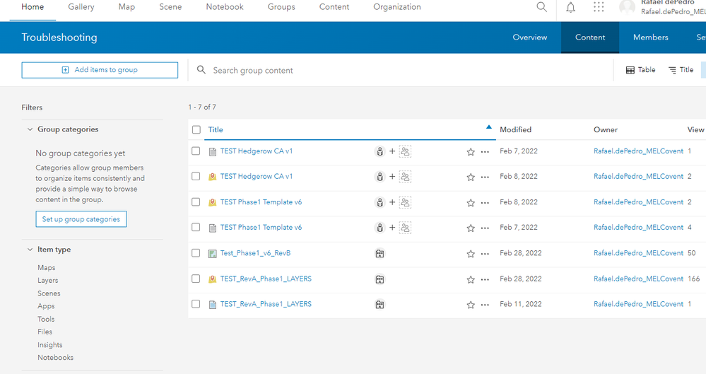

@CraigGillgrass  I don't know why that's happened. I haven't moved the map anywhere. I include a screenshot of the contents in the Troubleshooting group. The map TEST_Phase1_v6_RevB is there and should be accessible. It's the one with the original error which is now fixed (in a different map, not in the Troubleshooting group). But both the new map and the original Rev B map with the faulty layer contain the popup and hyperlink that opens a Survey123 form with missing information.
