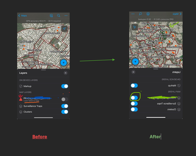

Here are the steps we followed to resolve the issue:
1. Access the rest endpoint of the join hosted feature layer view in Portal for ArcGIS : First, navigate to the Portal for ArcGIS and open the hosted view layer that is causing the problem. Modify the rest URL adding the word "admin". (Example show below)
2. Update Service Definition : Edit the join features service definition configuration to ensure there are no duplicate field names. This step is crucial as the error message "Geodatabase duplicate field not allowed" is triggered by these duplicates. You should change the visible variable to false and name the globalid field of the related table that repeats. There should only be one globalid field in the definition file.
3. Save Changes: After making the necessary adjustments, save the changes and refresh the hosted view layer
4. Test in Field Maps: Open ArcGIS Field Maps and load the hosted view layer. You should now be able to access the layer without encountering the error message.

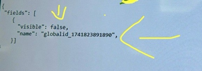

  • Scroll down and make note of the second globalid field, the one with a bunch of random numbers at the end. I believe it will always be the second-to-last field. In my case it was "globalid_1649266887779".
  • At the bottom of the page, click the Update Definition hyperlink
  • Change the format to JSON.  Use the following text as input, updating the globalid field to match yours
    "fields":[
            "visible":false,
            "name":"globalid_1649266887779"
  •  Click the updateDefinition button. You will hopefully see "success": true
