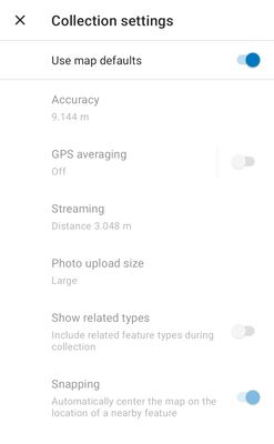

Good morning,

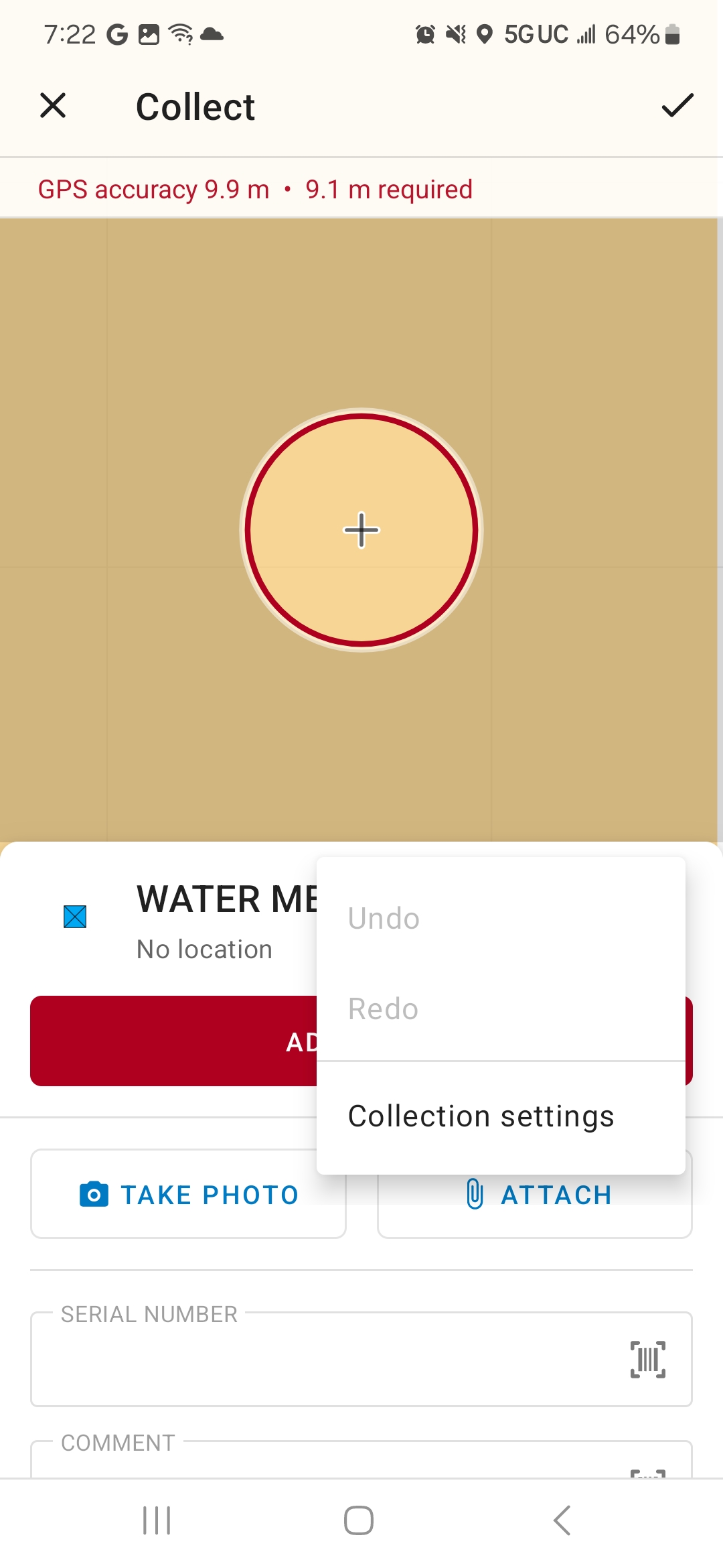

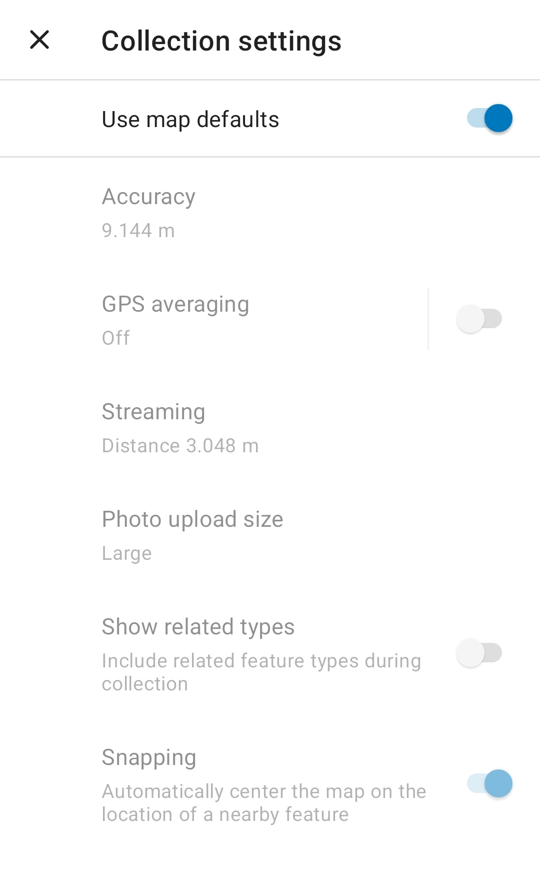

I have noticed in the last week(ish) that the averaging in Field Maps has to be enabled during the collection process. For example, select the "+" > select the feature to be collected > (then no averaging) > select the "..." of the feature > Collection settings > Disable "Use map defauts"
We never had to do this before, once the collection settings were set on the main 'Profile' menu it was set. Is there a way to go back to that configuration, instead of this new process or is this a bug? Thank you

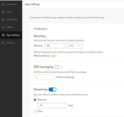

Okay I just figured something out. About a week ago I went into Field Maps Designer and added some filters onto some feature layers and saved the map. I opened Designer this morning and looked through all the settings and found the "Configure the default app settings mobile workers will use with this map." under App settings. I think this is what I enabled when I saved the map previously. Anyone know if there's a way to disable this default map setting, or it just automatically gets enabled when saving a map on Desginer? Any info would help, thanks
