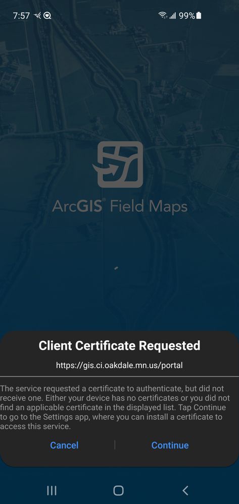

Yesterday, I started to get this error on my Android phone.  I have the latest Field Maps and Collector app and my Android is fully updated.  Not sure why I got this error today, after never receiving it...  I have attached the screenshot from my phone.

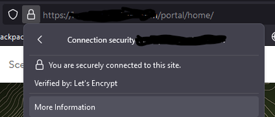

  • From desktop: navigate to your portal URL and view, cert info click on padlock icon next to the portal URL
    Click More Information

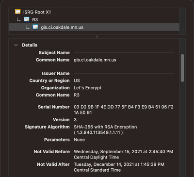

    View Certificate
  • Click the R3 tab and scroll down to 'Miscellaneous' and download PEM(cert)
