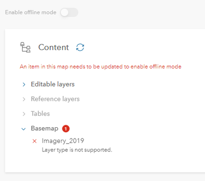

Thanks for the reply.  I may have found the cause, at least it is worth investigating.  I had replaced an Esri reference basemap with an aerial image.  It appeared that on shorter walks, I could get away with using the image and collect the path.  I went back into the configure Field Maps browser window, and saw the error about needing a map layer that is supported for offline mode.  I switched to an Esri reference basemap, and the error went away.  I will give this give this configuration a try.

@JayHodny I was able to reproduce this on my own devices. We have logged an internal issue to investigate further. I do not believe it is related to your basemap layers. Some things I have found that seem to alleviate the issue:
