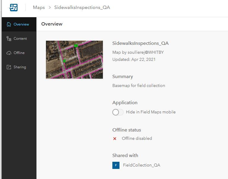

I do not see the Settings tool that is available in AGOL version of field maps that allows you to control the photo settings.
I have FieldMaps 20.4.0
