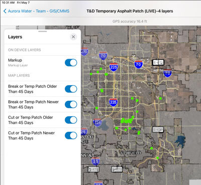

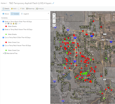

We are experiencing issues with layers not drawing in Field Maps when they are filtered by date using 'not in the last' or 'is blank'. The map was built in Map Viewer Classic, and the layers display properly there and in Collector. Our field users are on iPads with Field Maps. When I open the map in Map Viewer (new), it says it has 'Problem displaying filter'. I tried to rebuild the map in the new map viewer and it makes me resave the filter each time I click on a layer. Even then, using the date filter 'not in the last' or 'is blank' means the layers won't display on the tablet. We have a number of maps that use 'in the last' filter that appear to be displaying properly. No error message is thrown saying the layer didn't draw properly. We have confirmed that it is not just one map showing this issue.
Desktop:
Field Maps on iPad:

Hi @ErinCourtney ,
This sounds like a known issue we have logged that occurs when using the 'not in the last' filter. I can add a note that it is also reproducible with 'is blank'. If you have access to support I would suggest opening a ticket and getting attached to BUG-000121972 That way you can track the status and any updates.

We ended up with a workaround using Arcade expressions for the symbology. Here is an example of one:
 //number of days since anticipated asphalt patch date
var asphLength = DateDiff(Today(), Date($feature["ANTICIPATED_ASPHALT_PATCH_DATE"]), 'days')
//return 'true' if anticipated asphalt patch dates is blank
var tempNull = IsEmpty($feature["ANTICIPATED_ASPHALT_PATCH_DATE"])
//classify as 'needpatch' if asph length is longer than 60 days or anticipated patch date is blank
//classify as 'good' if asph length is less than 60 days and anticipated patch date is not blank
When(asphLength >=60 || tempNull == true, 'needpatch', asphLength < 60 && tempNull == false, 'good', 'no info').
Hope that's helpful.
