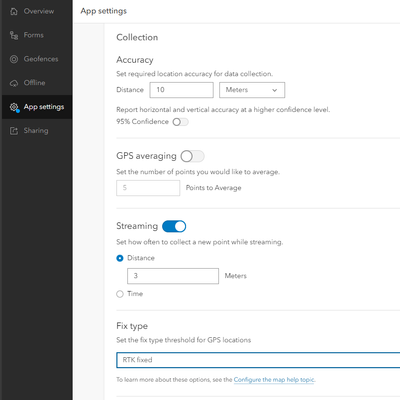

Y_Chau
@mykola you can set fix type threshold to RTK Fixed and set the location accuracy value via Field Maps Designer. This can be done in both AGOL and Portal.
mykola
I do not see an option to set RTK Fixed Only but I can specify the accuracy threshold for example within 1 meter or less. The problem with that is sometimes we get relatively good accuracy even though it if float and it did not work out well for several times. Having different symbology for non-Fix data could be an interesting solution that I have to investigate.

Y_Chau
This setting is in Field Maps Designer web app. It does not depend on the make of GNSS Receiver.
mykola
Seems like this setting is available from the version 11.2 onwards. We have an older version and no surprise that I haven't seen this one available in the settings.
