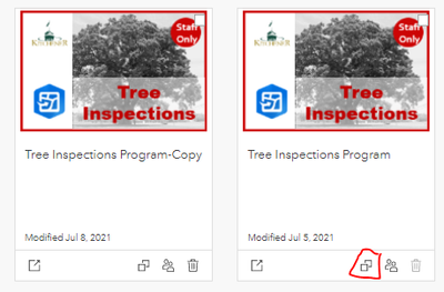

To add to the thread, today the edit plus sign was missing in field maps but only for one out of three users, all on iPad all using the same application. Here is what was reported from the user with the issue after I copied the map in field maps to a new document:
Here’s what I found
  • I’ve re-logged in as myself a few times now and the “plus sign” still doesn’t work on the original app
  • I logged in as myself under the copy of the APP and “plus sign” shows up
  • I logged in using the forestry user account in the original app the “plus sign” doesn’t work on the original app
  • I logged in using the forestry user account  in the copy of the app and the “plus sign” shows up
Regardless of how I’m logged in the original app details indicate “Read Only”, while in the app copy details indicate “Editable”
Again this only seems to be affecting my iPAD, as everything works fine on my iPhone and no other users have reported an issue. I thought the issue might be because I’m logged in on 2 devices (iphone and ipad), but this doesn’t seem to be the case.
The only thing I did was copy the map using the copy button in field mapsand give the same group access but that was enough to fix the issue. The app worked fine the day before. Hope this helps solve what is going on in the backend.

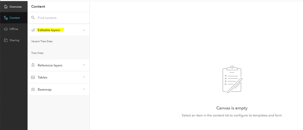

BrittanyBurson
Hi @KevinBurke , we are using Field Maps in Enterprise 10.8.1 with Map Viewer Beta.

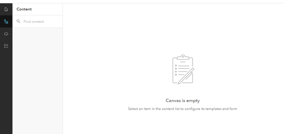

We appear to be having this same issue, where the "Canvas is empty" and acts read-only if the map contains any Public layers hosted in ArcGIS Online. It shows no configuration or editable layers available.
Map contains AGOL Public layer:BrittanyBurson_0-1629325968692.png
Same map with AGOL Public layer removed:
I tried a few different types of layers from AGOL and they all seem to cause the same problem. They are indeed visible, however, as layers in the Field Maps app without any issue -- it's just the configuration aspect that is stuck.
