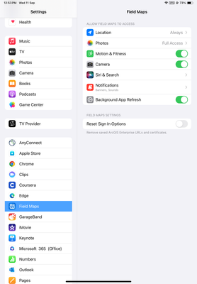

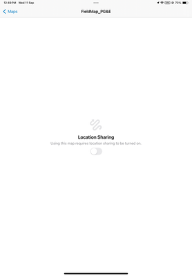

Dear @DougBrowning , Thanks for your reply. I am using iPad WiFi only tab.
But I was asked to switch on the location when I opened my project in Field Maps app. And I can also see location option in app settings -> Field maps settings.
Please check the below pictures for reference.

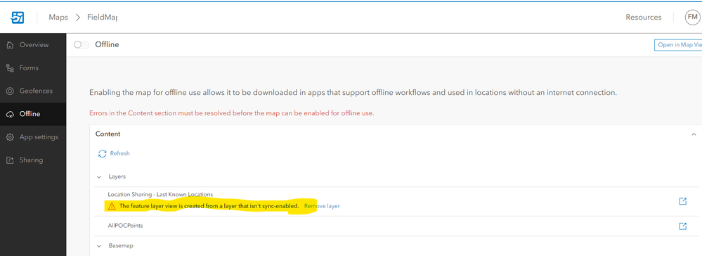

In order to achieve same thing in offline, map should be offline enabled, so that map can be downloaded in FieldMap app for offline use.  But I am getting an error that "The feature layer view is created from a layer that isn't sync-enabled".
I understood that the feature layer "Last Known Locations" Sync option is disabled. This layer is created as Feature Layer (hosted, view) and actually created by system when we create a project from Track Viewer app. And there is no provision to make Sync enable for this layer in Portal item settings and in ArcGIS server settings.
I think, if I can resolve the above error, I may get succeed in offline map also
Please suggest how to resolve this issue or any other process.
