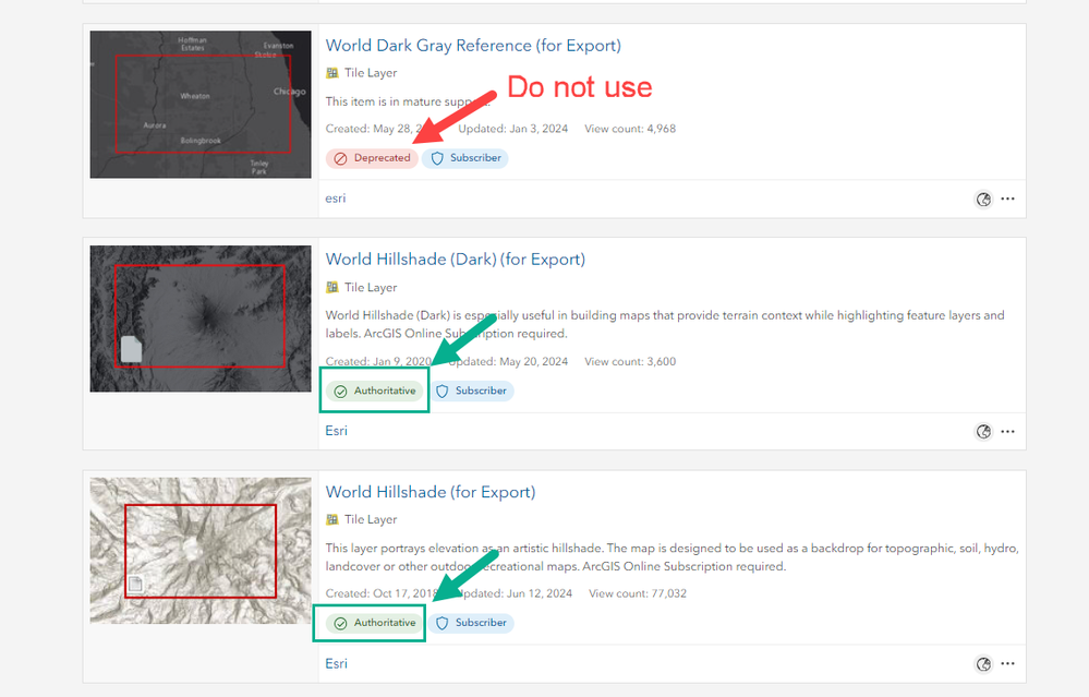

I have seen this issue resolved by changing the basemap to the World Imagery basemap. What basemap is being used when the message occurs? My recommendation is to use only the authoritative basemap to avoid the error. Refer to this link: https://www.arcgis.com/home/group.html?id=3a890be7a4b046c7840dc4a0446c5b31&view=list&focus=layers#co...
Additionally, ensure the basemap being used is not deprecated BaseMapSuggestions.pngBaseMapSuggestions.png
