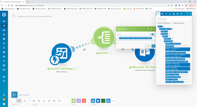

I am trying to setup an Integromat scenario and when I include the Iterator, it does not have the attachment/photos to add, so that I can include them in an email.  Am I missing something here, or why isn't this available?

Attachments are not supported in the Field Maps Integromat app. It only listens for added, edited, or deleted features. It does not listen for attachment changes.
When do you want the scenario to execute? There's a few workflows here:
  1. Submit a feature with just attributes and geometry
  2. Add an attachment to an existing feature
  3. Submit a feature with attributes, geometry, and attachment(s)
You can probably make an additional API request with the Make an API Call module to find any attachments. We don't have any examples of this though.
Feel free to add an ArcGIS Idea for this though, it's something we considered supporting but deferred.
