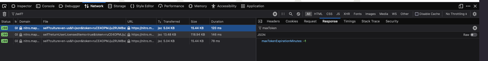

@DEIit's basically this https://enterprise.arcgis.com/en/portal/latest/administer/windows/specify-the-default-token-expirati... but for ArcGIS Online. The easiest way to check is probably by opening your browser and opening the dev tools and checking the network tab for a call to "/self?" and then open ArcGIS Online (assuming your already signed in)
DEI
I think I found it but do I change the value here and if so what should I change it to?
by Anonymous User
Not applicable
That looks right to me. -1 means it opts into the default which currently is 90 days. So I don't think there's an issue with your organization settings.
