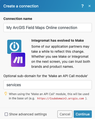

Your connection should look like this when you configure it correctly with a subdomain:
For existing connections you can view them and it should look this:
Where it's {username} | {portalURL} | {federatedServerURL}
What does yours look like?
