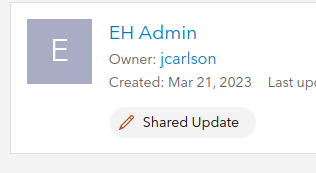

An item in AGOL can only be edited by three kinds of users:
  1. The item's owner
  2. Organizational administrators (or users with custom roles that are equivalent)
  3. Users in a group to which the item is shared if the group has the "shared update" capability
So you will want to double-check the group. Does it have this capability? You'll see it noted clearly:
If that capability is set, then yes, your users could mess with the map. If not, then no worries! They can only interact with the map, but not change its settings.

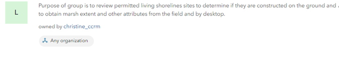

Hi Josh - Thank you for the reply.
My group does not appear to have Shared Update shown on yours.

ChristineTombleson1
This is what my group looks like, it doesn't appear to have the Shared Update as yours does.  So this means that users can update data in the Field Maps using the map but cannot alter the map at all? If this is correct, that is exactly what I need!  Thank you!!!

That is correct! They can use the map, but they can't make any permanent changes to its configuration.
