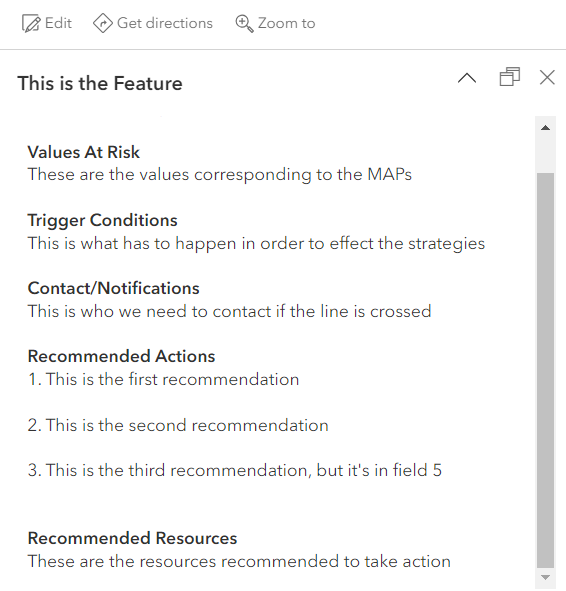

Here is the resulting popup in a web map:

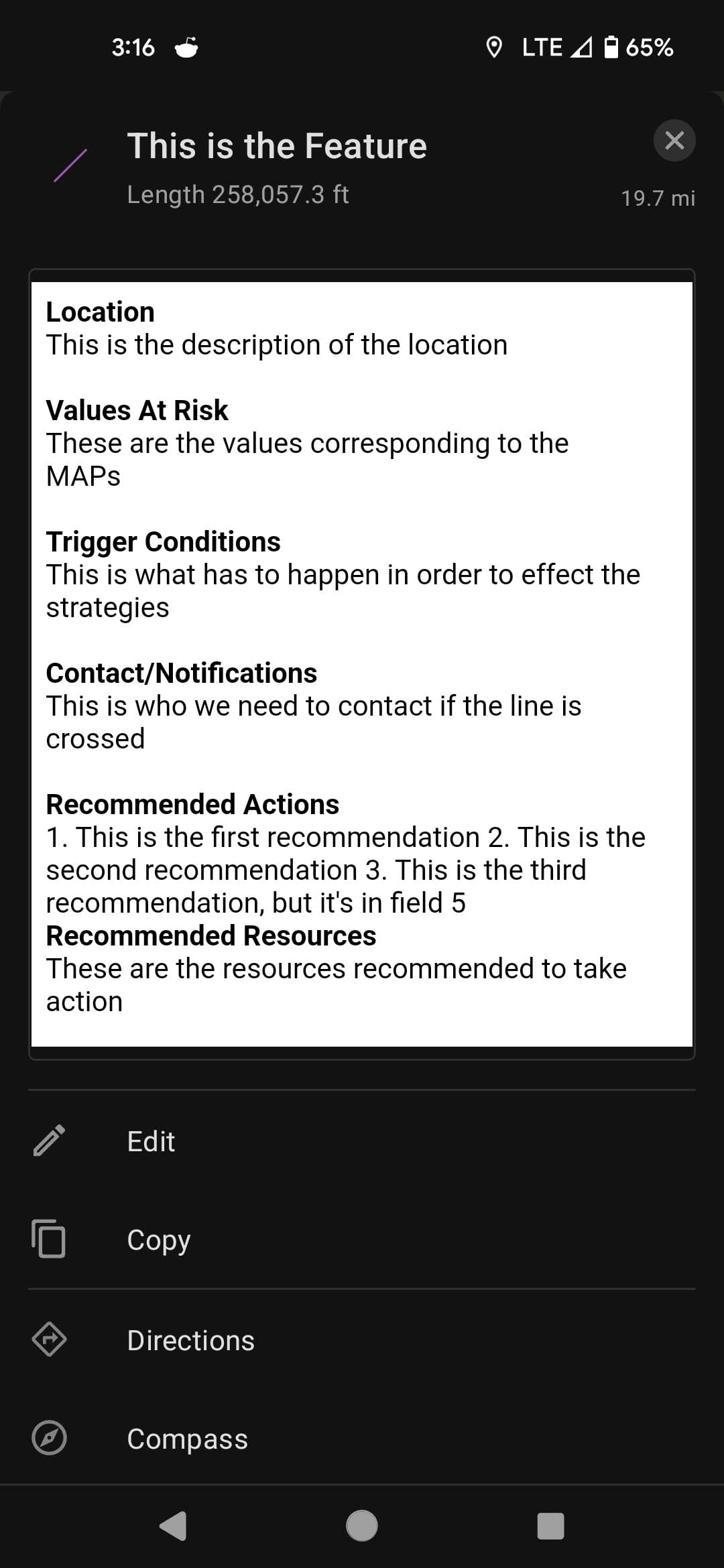

And here it is in Field Maps (Andriod, but iOS gives same results):
Obviously, the Recommended Actions are what are created by the expression.
The product is usable, it's just not clean. Does anyone know how I can split those actions onto new lines?

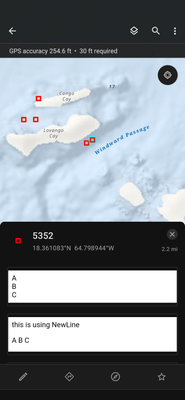

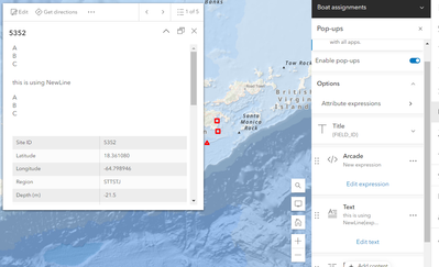

Field Maps does not interpret "TextFormatting.NewLine" or "/n" properly. If you want to add them, you have to use the Arcade element in the popup. I've created a popup using an Arcade element and a regular Text element. The Arcade element uses this code
var test = ['A','B','C'];
var output = '';
for (var i in test)
	output += `${test[i]} <br/>`;
return {
	type : 'text',
	text : output //this property supports html tags
The Text element uses this expression
var output = '';
for (var i in test)
	output += `${test[i]}${TextFormatting.NewLine}`;
return output;
While they both render properly in the Map Viewer popup, the Text element doesn't render properly in the Field Maps popup

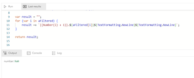

What happens with this expression?
var aRecomm = [ $feature.Recommen_1, $feature.Recommen_2, $feature.Recommen_3, $feature.Recommen_4,$feature.Recommen_5,$feature.Recommen_6,$feature.Recommen_7,$feature.Recommen_8,$feature.Recommen_9];
function FilterNonEmpty(value) {
    return !IsEmpty(value) && value != "" && value != " ";
var aFiltered = Filter(aRecomm, FilterNonEmpty);
var result = "";
for (var i in aFiltered) {
    result =+ `{(Number(i) + 1)}.${aFiltered[i]}${TextFormatting.NewLine}${TextFormatting.NewLine}`;
return result;
E_-_MattReed__GISS_
Thanks for the attempt, but.... not a number...
