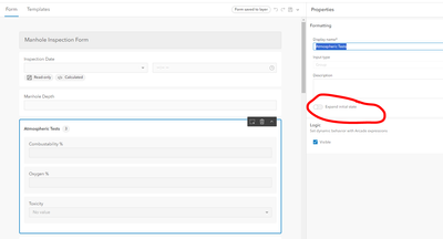

Yes, just toggle the switch in the forms designer.

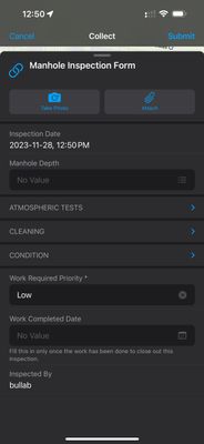

Shows up like this initally:

You need to add a "Group" to the form, which is where you can set the toggle.  Then you can add as many attributes into the group as you want.

Hi again - This toggle switch appears to only work on the Smart Form in Field Maps, not the popup of the layer. These are two different things, at least how my app is configured.  So still searching for a solution.
