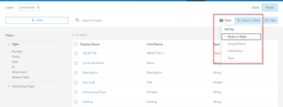

Hi, when you say "...go back to view the details of that record, the Details tab shows the fields in a different order."  Where are you viewing the record and accessing a Details tab? In the Map Viewer?
If you are viewing the layer's fields from the item details page, you can choose how you want to view them (screenshot below). If you are talking about something else, please provide a screenshot if possible!

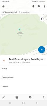

Hi @KaitlinFinan, no I mean within the Field Maps mobile app still.
E.g. in a test version I've done, the field order in the Field Maps map viewer>Configure Fields initially starts as Name, then Creation Date. In the smart form builder (in the Field Maps web app) I have changed the collection order of the fields to Creation Date, then Name. I also changed the pop-up field order in the web map to Creation Date and then Name.
When I am collecting data in the mobile app, the order matches the smart form order, i.e. again Creation Date then Name. However once you go back - in the mobile app - to a previously collected point, the order of the fields shows as Name then Creation Date:
This is just a test example, but with my other project the order of the fields when users are reviewing already captured points is more important.
