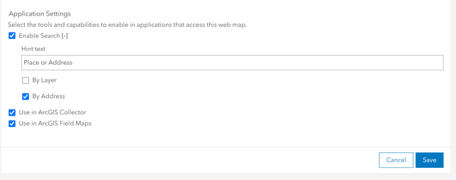

Hi,
I'm working in AGOL.
I have a field map containing a read-only map.
I want to create a QR code containing a link that will open the Field Map and zoom to a particular feature.
The updateFeature context complains that the map is not editable so I'm looking at the search context and search URL parameter.
The documentation for the search parameter states 'Features are identified using the same terms used to search for them in the map.'
Can someone explain to me what this means? Where does one configure fields to search by in a web map?
Are there other ways to accomplish what I want to do?
Thanks
Hanlie

HanliePetoors
@RickeyFight thanks for the reply.
So it looks like one can only search the ArcGIS World geocoder? I was hoping to search fields inside the feature service, such as the Global ID.
DougBrowning
MVP Esteemed Contributor
Go into the layer service settings in AGOL and at the bottom you will see you can set up the search to whatever field and layer you want.  This is what it will use when you send the search term.
HanliePetoors
Sorry for being dense but I'm not sure where to set up the search. I checked the feature service's settings, no search parameters.
I checked the layer's settings in the web map. In there are URL parameters but that seems to function to parameterise the layer before it reaches the map?
Thanks
Hanlie
DougBrowning
Sorry my bad it is in the map settings.  Sorry its early.  Can change to By Layer here at the bottom.
HanliePetoors
Thanks @DougBrowning I got it. Seems like the global ID is not an option but we have another unique field that we can use.
