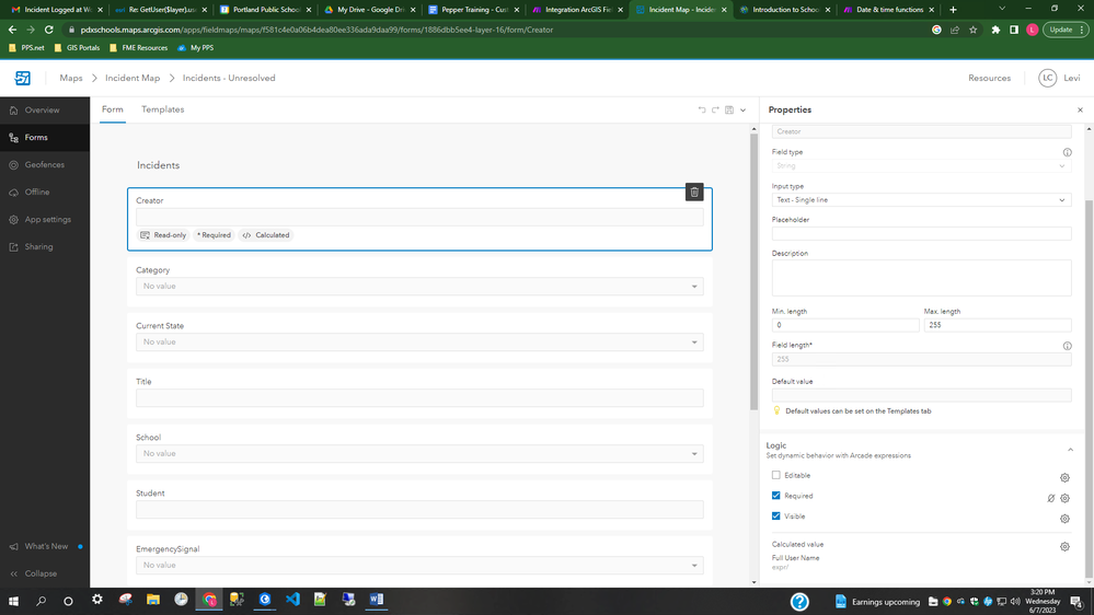

I'm trying to calculate full user names in a Field Maps form for an AGOL map. The GetUser($layer).username function works in the Arcade editor in Field Maps designer (prints "Levi Cecil" as opposed to my username "lcecil5") but this data doesn't write to the attribute table. It's just null. I've seen a lot of posts about how this function doesn't work offline, but I'm strictly online.

Well, I just got it to work sort of. I set the field to "required" and "visible" in the Field Maps and my name showed up in the field in the Field Maps form. I'm working on webhooks email notifications in Make at the moment, and the output is weird. It has [Collection] before my name. WTF??
Logged by user: [Collection]Levi Cecil
