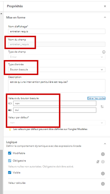

Here is the configuration of this field in Field Maps Designer:
Name of field: entretien_requis
Type d'entrée/input type: Bouton basciule/switch button
And then the possible values: non or oui
You can also see the default value is present ("non") and greyed out.

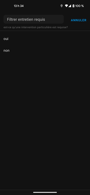

However, I don't see a switch button in the field maps app.

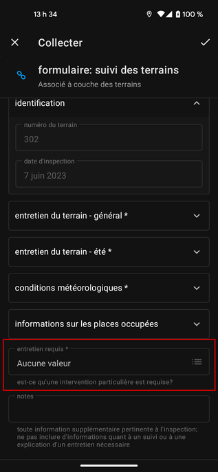

I recharged the map, and this is what I get:
On loading form, "Aucune valeur" means no value/null, however it should be by default "non" or 0:
Then when clicking on the list, the shown options are correct.
Then when closed again, "non" is selected but still no switch button.

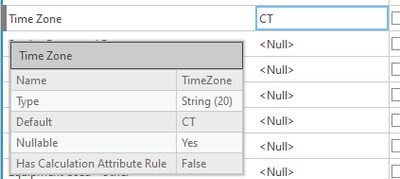

Assuming you published this service from ArcGIS Pro, I suspect your feature templates were not honored when published because they were not actually "stored" as ESRI calls it. You can check the templates in Pro to see if what you published has the values "stored".  This is in Pro 2.9.x.
From the Manage Templates Pane, select a template and view it properties.

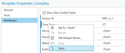

The blue line to the left of the field indicates that the default value as NOT been stored in the feature template.  If the default is <null> then that is okay, but for an field with a default value that is a problem.  There appears to be a bug "or a feature" with this as a "Field that is using the geodatabase default value" are not actually honored when published.  This is an issue we saw way back in Pro 2.5 and we reported it.  It appeared fix in 2.6 and 2.7 and then in 2.8 it appears to have reverted back to being a problem. At any rate storing the values seems to fix the issue with feature templates once published.
Right Click the field and choose to "store" the value.
After storing the value the line will change from blue to green.
Viewing the field again after having stored and save it the fields having default values stored (which may or may not be the same as the geodatabase default value) will be gray.
