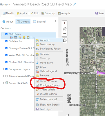

If your user role allows you to author/edit online maps, you enable/config the pop-ups by clicking the ellipsis (...) to the right of the data layer in the Table of Contents on the left side of the online map. If you are using a Web App in the field, you have to make the pop-up changes in the parent Web Map, which will then carry over to the Web App.

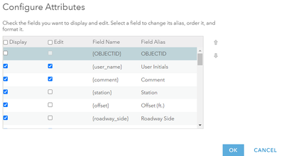

When you choose "Configure Pop up" a dialogue box opens that allows you to define how the popup will appear to the end users when a feature is selected. A second dialogue box is available from that screen for further configuration, allowing the author to choose which fields are visible and which are editable, giving the map author good control of the online map experience.
