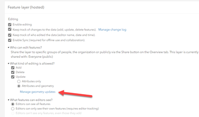

Not sure about portal, but AGOL that can be set in the item details of the HFL.  Can be set for each layer in the HFS:

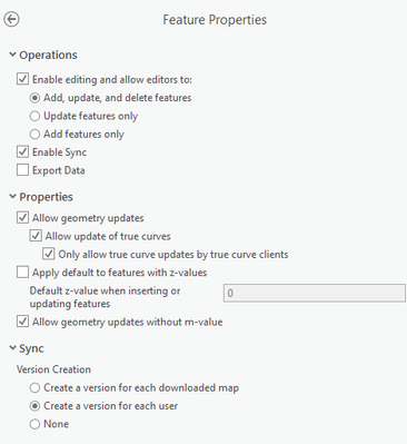

No, that's not available in Portal but thanks for the information anyway. I know what to look for. Just don't know where it is. This is the only place I found the ability to choose an editing function. It's configuring the feature when publishing a map to the server.

That's not necessarily right. I published my service with "Allow geometry update without m-value" enabled and it is still not possible to move a point manually on field maps and add the point.
I remember I used to be able to do that however now it seems a point can only be added if I press first the "locate me" button and then the add point turns green.

We were able to resolve this issue by selecting "Apply default to features with z-values" for the published feature service.
vaishalikulkarni00
That was the issue. It was the z-values. Thanks.
