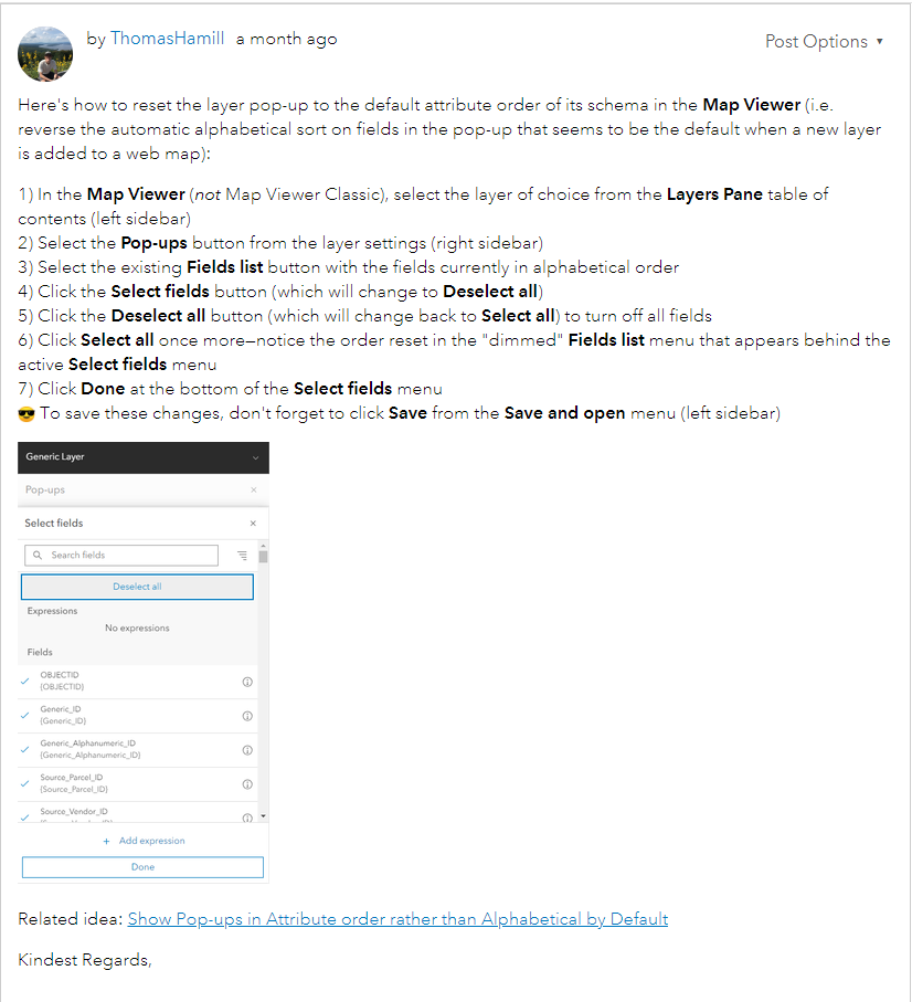

cat206
Hi All, Thomas has posted a great work around to change the pop-up view to be in attribute order rather than alphabetical (new default). Re: New Map Viewer Popup Field Ordering - Page 2 - Esri Community
