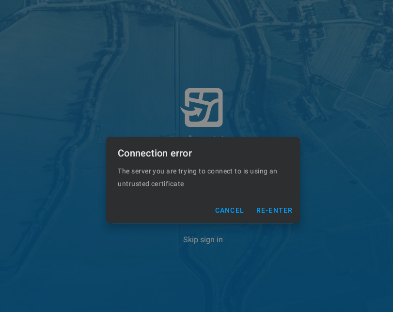

We are trying to run Field Maps onto Windows 11 on the Android Subsystem.  We can open field maps and can connect to AGOL.  The problem is we want to use for our internal ArcGIS Enterprise.  For ArcGIS Enterprise we use a certificate signed by the domain CA.
When we connect to our portal from Field Maps, we get an error about an untrusted certificate.  The problem is there does not seem to be a (straight forward) way that we could load the root certificate onto the device.
Does anyone know how this would be done?
