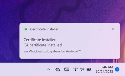

  11. Certificate is installed (you should see popup as shown below)

Certificate Install popup:
