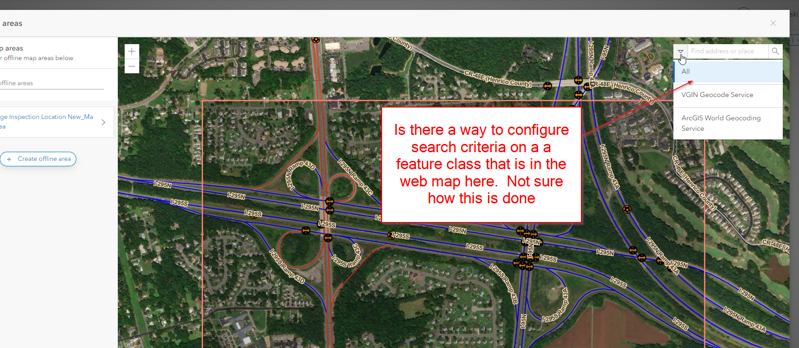

I have a question regarding the screen where you define work areas to be packaged up for download by field users.  There is a search option in the top right hand corner that allows the user to specify an address etc.  This is also in Web Applications but in web applications you can modify it to search a feature layer attribute field.  Can you do this in the Offline Selection Area of the Field Map web page?
I have tons of bridges and am looking for a way to search and zoom to them while I am creating my fieldmap packets...
ColinLawrence
Hi @kapalczynski ,
One way to accomplish this would be using Bookmarks in the Web Map. Save Bookmarks in the Web Map at the extents you are interested in and then when taking the map offline in Field Maps you can select from the Bookmarks you created to define the offline extent.
You are talking about Feature Search, which is configurable for use in Field Maps through the Web Map settings, however there is no search available in the offline area creation screen. This is why I would suggest using Bookmarks or create Pre planned offline areas from the Web Map settings page.
