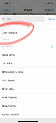

What I think is happening is that Field Maps is not set up to use 'RECENTS', and showing all values from 'OTHER'.
You should be able to type the 'missing' domain in the Filter bar and have it come up.
I've included a screenshot... I opened the same map in collector, tried to replicate the issue, and noticed that there is a recent field. Like a said above, I think Field maps is only pulling values from the "other" list.

I'm having a similar (could be the same) problem in the latest version on iOS 21.1.0 Build 385 but not in previous versions.
If our users select a domain value from the dropdown, save the feature and go on to collect another feature, the domain value is no longer in the list of options.
It displays when using filter but is no longer in the main list. I suspect it has something to do with Favourite/Revent options. I no longer see my Favourite/Revent items in the list and assume that the value is moved from the main list to the Favourite/Revent. If Favourite/Revent items are not being displayed, the value is not visible and a user will not be able to select (except for using the search option)
Screenshot attached, top shot is the list after selecting the field in the form, bottom shot is if using the value filter. 'Maintenance Required' and 'Minor Defects Only' are not in the initial list until filtered for.
