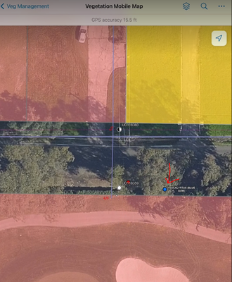

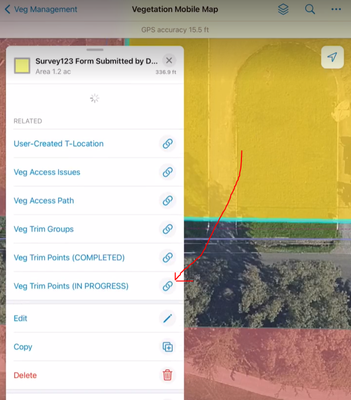

Has there been a resolution to this? If it's what it seems like you are describing, we might be having the same issue. Intermittently, points that are there are NOT showing up on the map...and will appear ONLY after the related parent feature (a polygon in our case) is selected.
There is a point right here that is not showing:
Then, only after we select it's parent polygon, and select the related point layer...it appears.
Similarly...this is causing major issues due to duplication of work in areas where crews are dropping points when there are already points there.
Any information on this would be greatly appreciated. Thanks!
