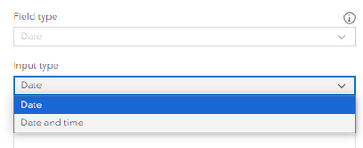

I am configuring a form in Field Maps and want to auto calculate the date so have chosen to use Now(), however this also adds a time. What do I need to add to this function so it only auto fills with a date not a time too?

While you wait for the DateOnly() function with to become available you can use the following:
Set the field's input type to "date" rather than the default "date and time".  The user will then only see the date.
You can also use Today() instead of Now().  Today returns the current date at midnight, which is what will be stored in the database, but since you set the input type "Date" the user will of course only see the date.
