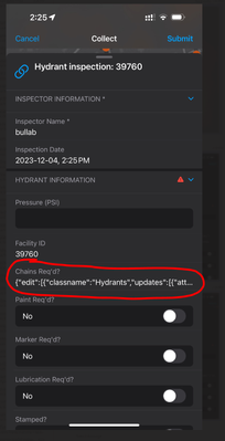

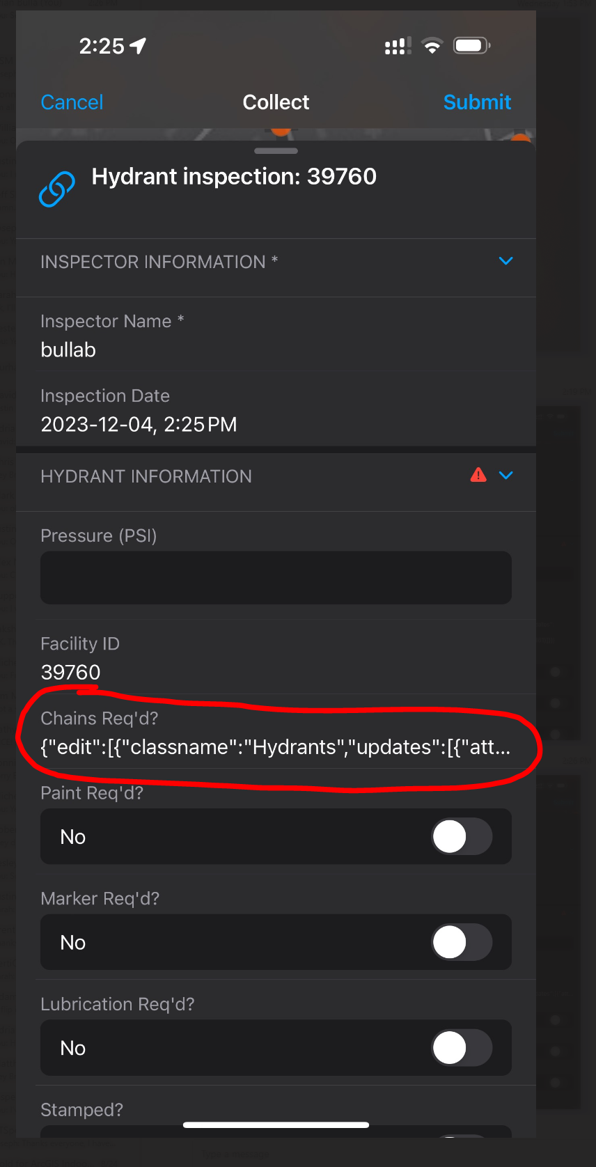

In field maps, all I get in the form is some text (the dictionary) where the switch should be instead of the code actually getting triggered like an event when the switch gets toggled by the user.
Is there a way to get what I want to do to work?  Either through Field Maps forms or some other way??  I've given WebHooks a try, but no success, but this seems like something that should be fairly simple to do.

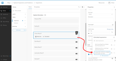

So I am setting this code on the respective field on the "Inspections" form.  See the screenshot below:

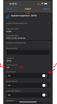

Now when I do this, I still don't get what I want.  What is happening is that a "WR" is now getting substituted for the "switch" control.  But what I want, is for the switch control to update the feature based on wether or not the switch is in the No or Yes position.....if that makes any sense.

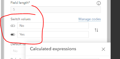

Ok I think you can change what the switch means there on the side.  Change the yes to WR if that is what you want.  All you are doing is changing the domain values.  Sorry if not getting it but seems easy enough.
